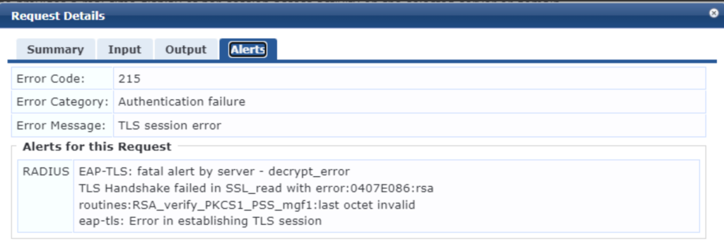

From ClearPass, the most obvious symptom is that some clients cannot authenticate and the error message is this in the Access Tracker:
Error Code:215
Error Category:Authentication failure
Error Message:TLS session error
Alerts for this Request RADIUS EAP-TLS: fatal alert by server – decrypt_error
TLS Handshake failed in SSL_read with error:0407E086:rsa routines:RSA_verify_PKCS1_PSS_mgf1:last byte invalid
eap-tls: Error in establishing TLS session
Screenshot of the ClearPass Access Tracker with the current error message.

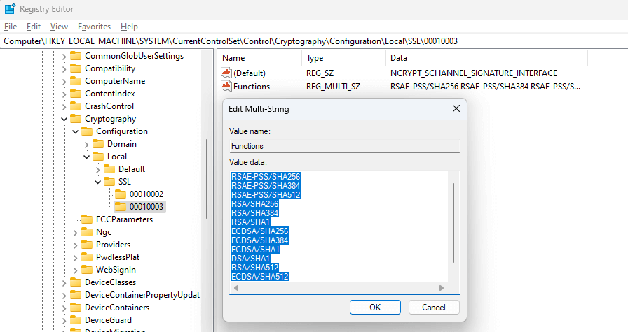

Disable PSS RSA in Windows
Computer\HKEY_LOCAL_MACHINE\SYSTEM\CurrentControlSet\Control\Cryptography\Configuration\Local\SSL\00010003
Delete the following values:
RSAE-PSS/SHA256
RSAE-PSS/SHA384
RSAE-PSS/SHA512
Screenshot of the Registry Editor showing the key to be modified.
